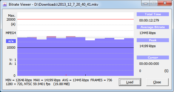

  13. Originally Posted by vhelp View Post
    that is odd since the hdpvr does not go up to 20Mbps.
    The header may say it's 20 Mb/s but it's ~14 Mb/s.
    anyway, i knew it had to be some detail you weren't giving us. if what jagabo's suggestion doesn't work out, then maybe try remuxing it with a different tool, and repackage it again, or play around with different muxing/packaging scenarios. i'd be curious to know whether or not your issue resolved.
    MediaInfo gives 13.6 Mbps as "Overall bit rate" (which is fine since I recorded at constant 13.5), but gives 20 Mbps as "Maximum bit rate", I don't know why.
